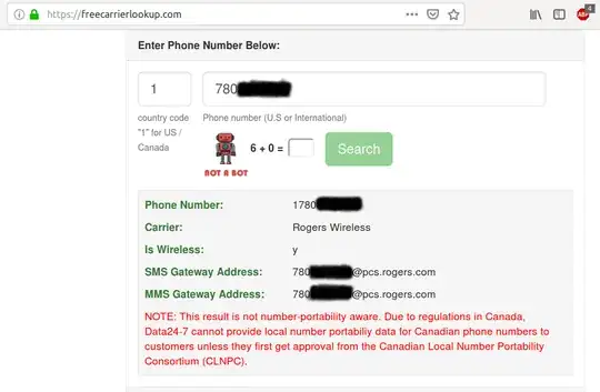

Phone Number look up to get carrier's website address
To get the provider's website address using the phone number go to: https://freecarrierlookup.com/. Imagine we entered the phone number: 7801234567:
We are told the email address to use is 7801234567@pcs.rogers.com. Now send an email to this address and your phone will sound with a notification.
