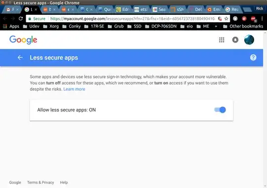

I used a pretty simple method to get cron to send emails: Backup Linux configuration, scripts and documents to Gmail.
Simplest way to automate sending email
From Send email alerts using ssmtp we find the simplest way of sending email automated from terminal or script. The installation steps are straight forward:
sudo apt install ssmtp
sudo nano /etc/ssmtp/ssmtp.conf
# Change "MyEmailAddress" and "MyPassword" to your own.
There is one step not mentioned; Google will send you an email confirming you want to allow a "less secure" application to send mail with your account:
gmail turns on less secure apps for email
There is an annoyance of getting too much mail. For example every time you mistype your sudo password you will get an email: Stop emailing me bad sudo password attempts
