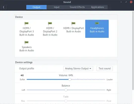

When this happens Ubuntu starts showing some additional HDMI (DisplayPort) devices in Sound settings (screenshot), and headphone option even after removing headphones, these devices are not listed normally. If I restart, it boots and shows a 'Dummy Output' under sound settings. This is how it looks when broken: Many new devices listed under sound options
