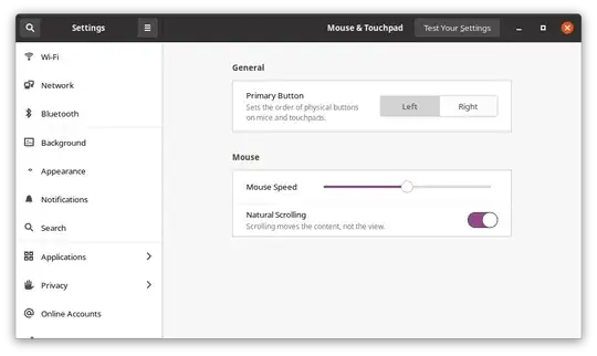

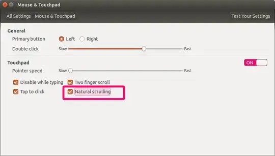

First way: using GNOME Settings
I don’t know which version of Ubuntu you’re using, but in Ubuntu 13.04 to Ubuntu 20.04 (I guess), it’s possible via Mouse and Touchpad settings.
So first, open System Settings > Mouse and Touchpad. As seen in the screenshot below if there’s an option for content sticks to fingers, check it. Then the scrollbars will work in reverse direction. I recommend clicking the "Test Your Settings" button to try it out.
Screenshot

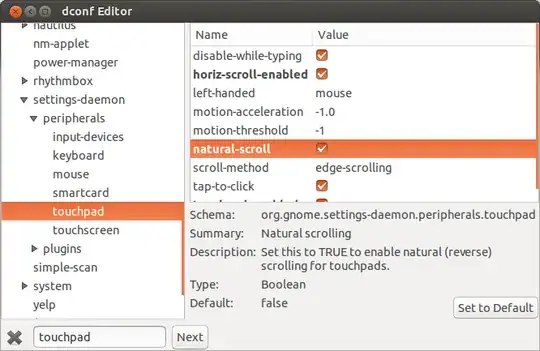

Second way: using DConf Editor
This is also accessible via DConf Editor as well. To install DConf Editor, run:
sudo apt-get install dconf-editor
Then go to org.gnome.settings-daemon.peripherals.touchpad and check natural-scroll.
You can also set this option on the command line:
gsettings set org.gnome.settings-daemon.peripherals.touchpad natural-scroll true

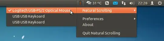

UPDATE: This solution does not work for apps that use GTK3, such as core Gnome apps like Nautilus (file browser). See D Charles Pyle's answer below for a workaround that works in all applications. Or follow Gnome bug 682457 for progress on a core fix that won't require a workaround.
You can use "Natural Scrolling" to have a system wide inverse scrolling.
What is Natural Scrolling?
Natural Scrolling is a GNOME Applet allowing you to reverse the direction of scrolling. You push your fingers upwards to move the page content upwards (and downwards for downwards) just like on iOS devices. Don't move scrollbars anymore but your file.
Install Natural Scrolling:
Natural Scrolling can be installed from its PPA.
Hit Alt+Ctrl+T to open terminal and run following commands:
sudo add-apt-repository ppa:zedtux/naturalscrolling
sudo apt-get update
sudo apt-get install naturalscrolling
How to enable Natural Scrolling?
Once installed, Hit Super key (Windows key) to open Unity dash and search for "natural scrolling" and open it. You'll see a new indicator in Unity panel, Click on it and select your device. In the preferences you can set it to start at login. That's it!

On Ubuntu 14.04 to Ubuntu 20.04, go to "Settings", then "Mouse & Touchpad" and select "Natural Scrolling".

The reverse scrolling you're talking about is called "natural scrolling," and can be enabled several different ways in Ubuntu. Here's an article on OMG! Ubuntu! detailing how to install the software that will get you what you need. If you're familiar with Ubuntu Tweak, you can also enable it in the latest release.

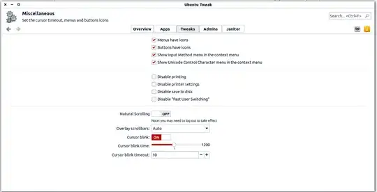

You can also use Ubuntu Tweak tool to enable natural scrolling (misc settings)
Screenshot
Official homepage with .deb distributive: http://ubuntu-tweak.com/
DJCrashdummy
  • 1,922
The naturalscrolling package doesn't seem to work for Ubuntu 12.10. I installed Ubuntu Tweak:
sudo add-apt-repository ppa:tualatrix/ppa
sudo apt-get update
sudo apt-get install ubuntu-tweak
and you can adjust scrolling at
Tweaks -> Miscellaneous -> Natural Scrolling
