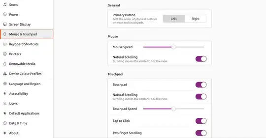

In newer versions of Ubuntu (Ubuntu 21.04, for instance), you can change this setting like this:
  1. Open "Settings"
  2. Navigate to "Mouse & Touchpad" in the left sidebar
  3. Enable "Natural Scrolling"
Screenshot
