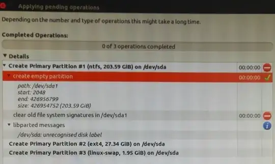

I'm running a Linux live USB with ubuntu 14 on it. From there I try to prepair my SSD for dual boot Windows 10 and Ubuntu 14. From the beginning it did not work very well and I had to reboot after the installation process started because it got hung up in between. Now, it is impossible for me to partition the SSD. I entered gparted while in live mode and it also creates a new parition table (MSDOS/MBR). Now I tried to create the following partitions:
  1. ntfs, primary, no label 203.59 GiB #for Windows 10
  2. ext4, primary, label='/', 27.34 GiB #for Ubuntu 14
  3. linux-swap, no label, 1.95 GiB #intended swap area
I don't know where the weird GiB numbers come from, I typed in 200 000 MB, 28 000 MB, and 2 000 MB.
Now this is the error that gparted gave me:
Gparted Error
(sry no internet for the live mode atm)

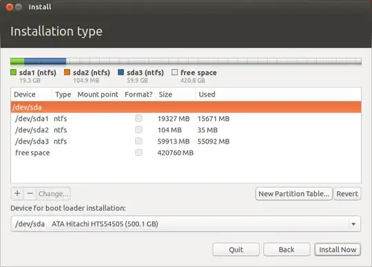

Lastly if windows still isn't detected after doing all this (but I 100% guarantee that it will be), select the option something else :
something else
which will open a menu like this (dumbed down gparted) :enter image description here
this thread has alot of the answers we're looking for : How do I install Ubuntu alongside UEFI enabled Windows 8?
I personally alsways used this menu because i didn't want swap especially not on my SSD! but now with ubuntu 17.04 canonical has finally removed that necessity and the "install allongside" no longer adds a swap patition. I digress.
just create two partitions with this tool. one 600 (or any size slightly over 500) megs in EFI one the size you want your ubuntu to be in ext4 with mountpoint / and the click "install now".
