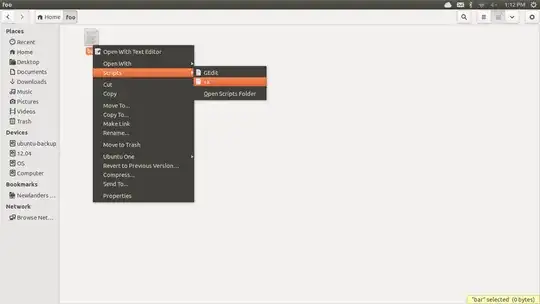

Try putting scripts in /home/$USER/.local/share/nautilus/scripts/
This is my scripts folder:
Nautilus Scripts Folder
This is the result:

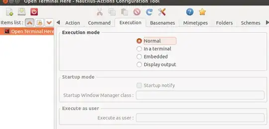

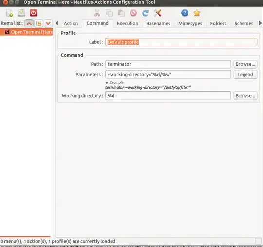

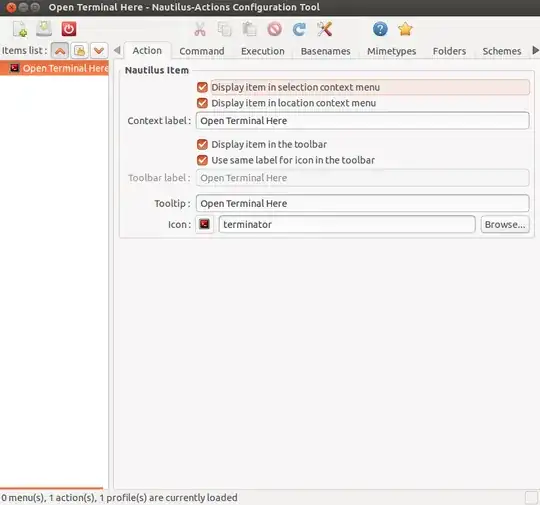

With this tool I was able to make a context menu item to open terminal here. I've followed these steps:
One thing to note... It didn't show up on toolbar, or I didn't know where to look for it. So you don't have to check those two boxes in the second screenshot.
The whole thing works nicely, and I can click on files/folders or empty space to open terminal on current folder. It took a little effort to find out that the correct variable for folder path was "%d/%w".
When I was in /home/logan/games:
  • %d would get /home/logan if clicked on empty space
  • %d would get /home/logan/games if clicked on any file/folder under games folder
But %d/%w seems to work for both empty space and on folder/file.
You may also need to logout and log back in, unless you restart nautilus to reload the context menu.
