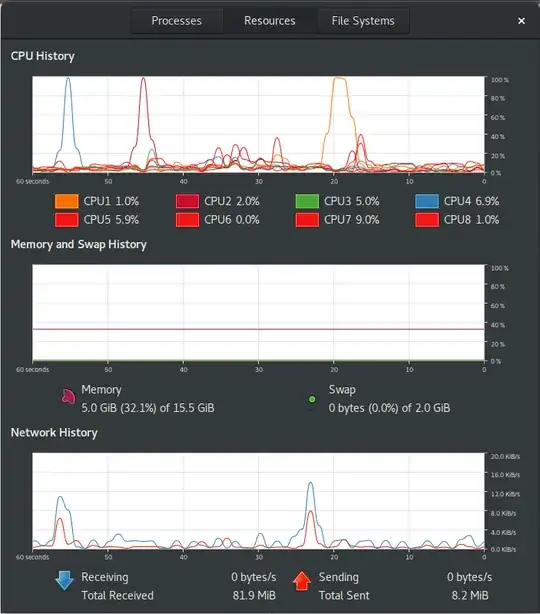

Each time gnome hangs there is a short peak of CPU usage and this is logged.

Problem still happening in ubuntu 18.04. Even worse some times the system crashes when using media keys.
