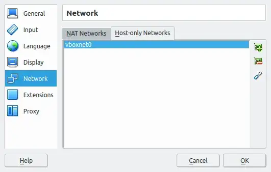

Create a host only network
In VirtualBox from file menu select preferences and in VirtualBox Preferences window, select Network, then host only networks. after all by clicking on + sign add a new host only network.

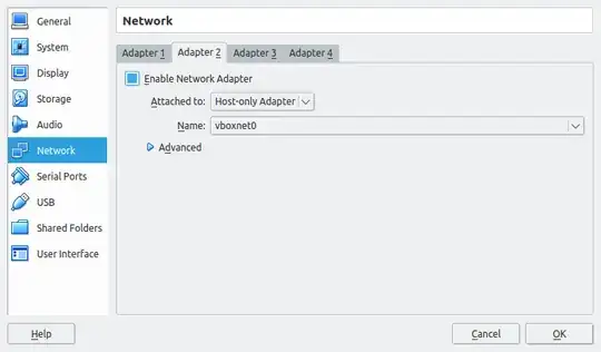

Add our machines to the same network
Now for both Ubuntu virtual machines, right click on each of them, select settings, go to network section. make sure Adapter 1 is active and is attached to Nat, click on Adapter 2, check Enable Network Adapter and for Attached to select Host-Only adapter. click ok to save these settings.

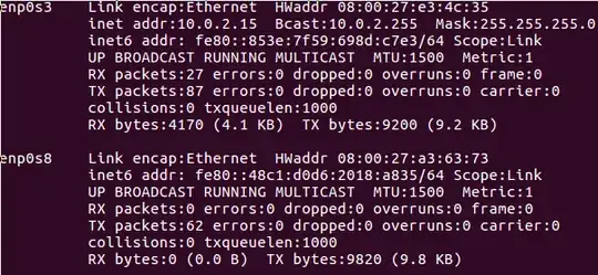

Then we should enable dnsmasq DHCP functionality, before doing that lets take a look at or network interfaces by running:
ifconfig -a
we should get something similar to this:
enp0s3 is or first adapter, do you remember the Nat interface? it's already has an IP (10.0.2.15), we don't have anything to do with this interface, we just created it to get Internet access if it was necessary for installing stuff, etc.
enp0s8 is connected to our vboxnet0 network which we just create it in first section, we should make this interface listing to DHCP request and response to them.

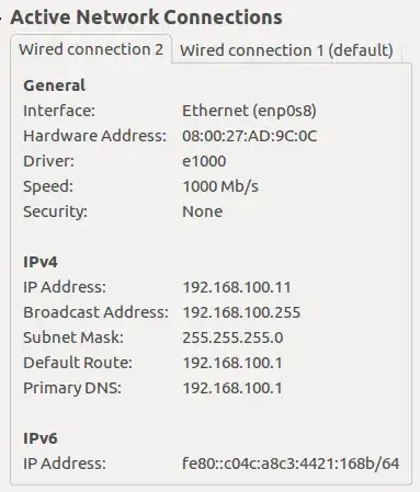

Turn on your other Ubuntu machine, it should have network manager installed by default, and a connection to this network should already be there. the default method is to use DHCP, so you have to do nothing. just enable the new network, the name should be Wired Connection 2, and done, your interface will get an IP.
If you have a look at network information, you can see that this interface has an IP in the range that we setup in our DHCP Server:
