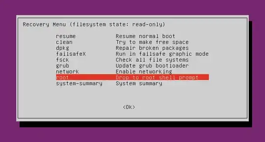

    Now you should see this recovery menu:
    recovery menu
  4. Using the arrow keys scroll down to network (the third entry from the bottom in the Recovery Menu) and then press Enter.
  5. Using the arrow keys scroll down to root and then press Enter twice.
    You should now see a root prompt, something like this:
     root@ubuntu:~#
