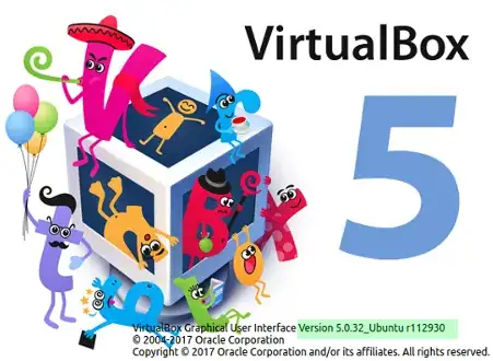

From GUI: to make sure correct version is running.
Help menu -> about virtualbox
Pay attention to green highlight
