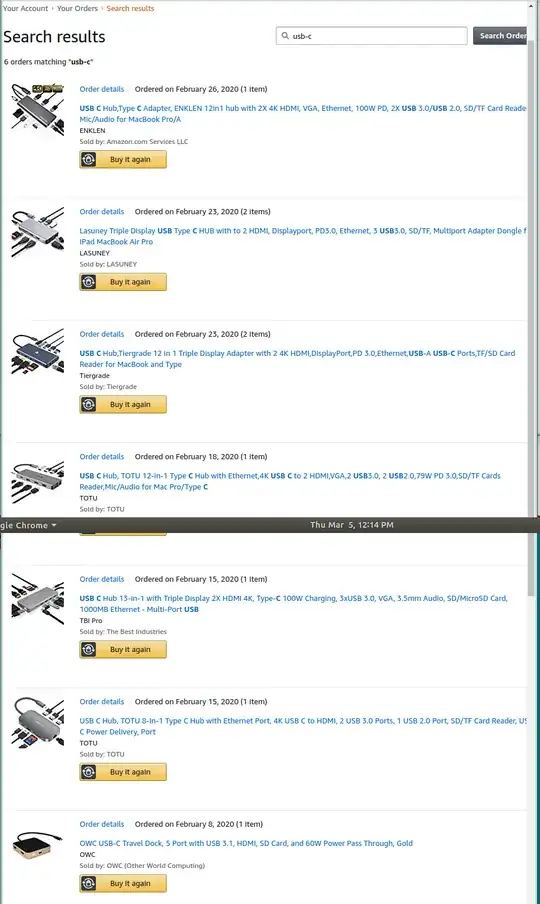

With Ubuntu 18.04, I just tried a series of docks via Amazon purchases, and found all of them lacking in dual independent external displays. Some displayed nothing, but most displayed duplicate external displays (show up in the settings as just a single). I have/am returning them all.
