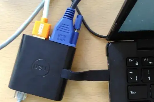

Note: As show in the picture below, I had to cut out one of the screws of the VGA adaptor.
USB-C Adapter
