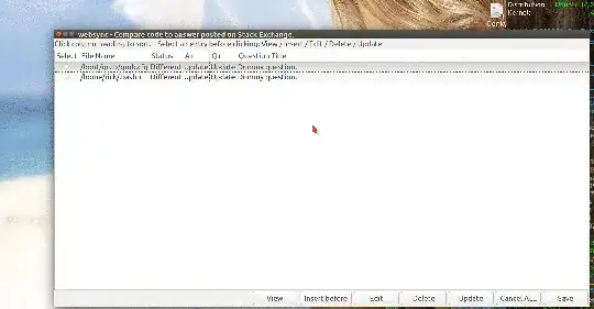

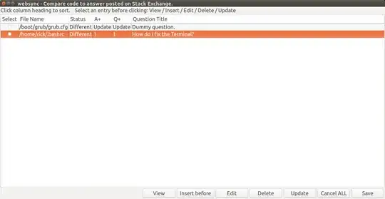

A “bash only” script is required to download Ask Ubuntu answers linked to source code (scripts) on my system. Then compare the two using the diff command.
The point is to discover if my code has been changed and AU answers need to be updated or has someone revised an AU answer I posted and I need to roll those changes into my code.
websync script

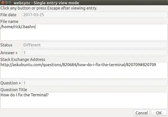

UpdateEntry () {
# PARM: 1=ONE display msgs, else file name for messages.
if [[ $1 == "ONE" ]] ; then
    bDisplayMsgs=true
    MsgFileName=""  # In case a single update follows all update
else
    bDisplayMsgs=false
    MsgFileName="$1"
fi

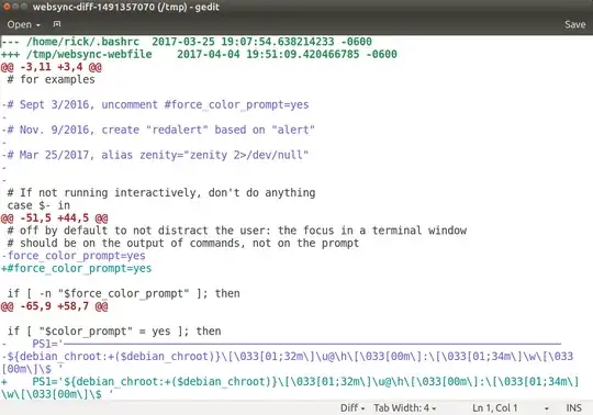

    diff --unified=2 -w -b -B -I --suppress-blank-empty \
        --ignore-tab-expansion --suppress-common-lines --ignore-all-space \
        ${RecArr[$ColFileName]} /tmp/websync-webfile > $FileDiff
    # If file doesn't exist, errors in diff parameters
    # If file size =0 there were no differences
    if [[ -f $FileDiff ]] ; then
        if [[ -s $FileDiff ]] ; then
            if [[ $bDisplayMsgs == true ]] ; then
                # File not empty.
                gedit $FileDiff
            else
                cat $FileDiff >> $MsgFileName
            fi
            RecArr[$ColStatus]="Different"

Sample Main Window
This demo screen had to be fast paced and frame reduced to fit within 2MB file limit. It shows the default data created when the script is first run. Here’s what’s happening:

  • The diff command compared the local code ~/.bashrc to the answer on Stack Exchange and gedit was used to display the differences.
Here’s what was missed after the animation ended:
gedit is used to display the differences between your local code ~/.bashrc and the stack exchange answer.
After closing gedit the main screen reappears and now the Question up-votes, Answer up-votes and Question title fields are populated.
Let’s drill down by clicking the View button
websync view button
Here you can see all the fields for an entry that don’t fit on the main screen. You can copy to the clipbaord the stack exchange website address which you could then paste into your browser. You can see the last modified date of the code file stored on your system.
The Status field could contain:
  • Update - A new entry was added or an existing entry was changed. The Update button must be clicked to clear all fields tagged as update and set with real values from Stack Exchange.
  • Bad file - The file name specified no longer exists.
  • Empty file - The file name specified has zero bytes.
  • 3 lines not found - The first three lines of the specified file (blank lines are skipped) were not found in the Stack Exchange answer. Either the wrong file name was entered or the wrong Stack Exchange answer was provided or the files have been changed such that the first three lines no longer match.
  • Bad Answer - The website address does not exist.
  • Answer < 1K - The website address exists but the answer is less than 1 KB in size.
  • Different - The local code file and the Stack Exchange Answer have differences.
  • Matches - The local code file matches the Stack Exchange Answer answer.
  • Diff parameter Error - The parameters used to call the diff command contain one or more errors. Use man diff to review valid options.

Explaining the sample main window shown above it displays scrollable entries containing:
  • Radio button to select an entry
  • The local file name containing code
  • Answer Up-votes (which your posted code and written answer are garnering)
  • Question Up-Votes (to show global interest in this SE question)
  • Question Title
A summary of main window buttons are:
  • View - view the selected entry.
  • Insert before - insert a new entry before the selected entry.
  • Edit - edit the selected entry.
  • Delete - delete the select entry (confirmation is required).
  • Update - download the answer from Stack Exchange and analyze it.
  • Cancel ALL - Cancel all changes (confirmation required if changes have been made). Escape key or X on Window has same effect.
  • Save - Save changes to disk.
