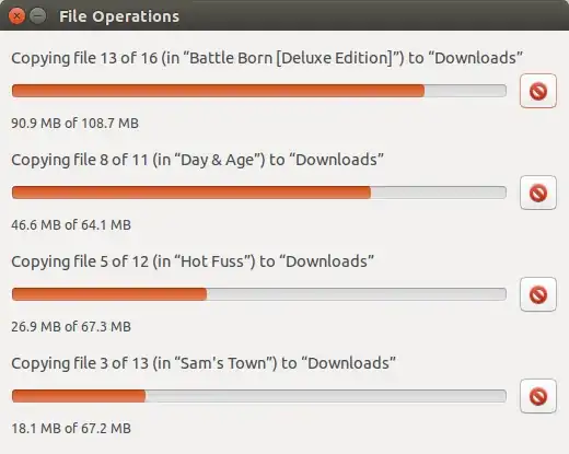

I'm writing my own script to download multiple items (simultaneously, one item per command) using wget and I need a progress bar. I currently utilize zenity --progress for my progress bars, but the problem is it spawns multiple progress bars when downloading.
What I want to achieve is something similar to the file transfer dialog in Nautilus:
Ubuntu's file transfer dialog
Can anyone point me to the right direction as to which program(s) or language(s) that will achieve this.

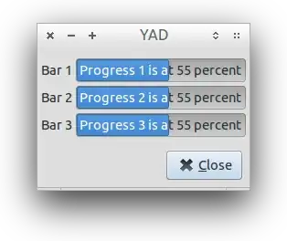

We can add descriptions to the bars with #:
for i in {1..100}; do
   printf "1:$i\n2:$i\n3:$i\n"
   printf "1:#Progress 1 is at $i percent\n2:#Progress 2 is at $i percent\n3:#Progress 3 is at $i percent\n"
   sleep 0.2
done | yad --multi-progress --bar="Bar 1":NORM --bar="Bar 2":NORM --bar="Bar 3":NORM
Result:

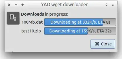

And this is what it looks like:
Make sure to read through all the comments to find out how the script works and if you have any questions please don't hesitate to ask in the comments below.

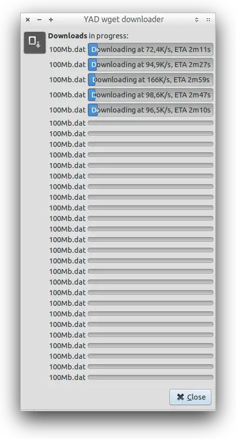

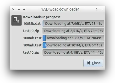

Edit:
I added support for setting the maximum number of simultaneous downloads. E.g. for MAXDLS="5":
