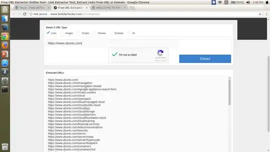

Something like this:
Enter image description here
The problem with this website is when I enter something like ubuntu.com/cloud, it doesn't show the subdirectories.

There are free websites which will do this for you and convert the output to xml format though. I suggest you look into one of those as well to see which method is more suitable for your needs.
Edit OP has included a new screenprint
