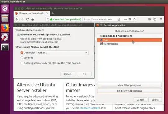

3. Set magnet links to vuze:
Click on a magnet / torrent link in Firefox and if vuze is not an immediate option (competitor would be transmission) you can easily navigate to vuze and select this as the new default. See the screenshot below for this seen on my own system:
This worked easily on my Xenial system and hopefully will on yours as well :)
