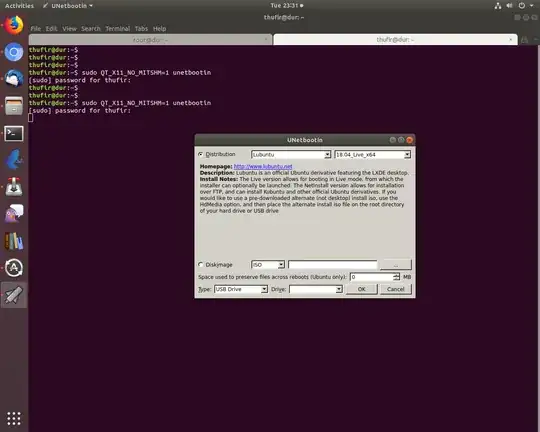

How can I create an ISO from unetbootin to then burn a DVD?
unetbootin
It looks convenient that the files are already there. Can they be packaged up as an ISO instead of re-downloading? (This is from plain vanilla Ubuntu, using unetbootin.)

No, if I understand correctly, Unetbootin can not burn a DVD, and I don't think it will unpack an iso file. (Maybe Unetbootin stores a temporary copy in the /tmp directory, that you could use for that purpose, but it would be better to get and use an iso file the regular way.)
You should use other tools for that purpose:
  • Download an iso file of Ubuntu or an Ubuntu community flavour and check (for example with md5sum) that it was downloaded correctly.
  • Use a burning tool, for example k3b and 'burn an iso file' with the slowest possible speed. It is a good idea to verify the burning process.

UNetbootin extracts an operating system ISO to USB and provides syslinux as a boot loader.
A program like Remastersys, (discontinued), or ISO respin, http://linuxiumcomau.blogspot.com/2017/09/new-version-of-iso-respin-script.html or Pinguy Builder, https://pinguyos.com/2015/09/pinguy-builder-an-app-to-backupremix-buntu/, may be used to put the files back into a bootable ISO.
Alternately you can use dd to turn the USB contents into an image file:
dd if=/dev/sdx of=~/usb2img.img
where sdx is the device id of the bootable USB.
The image file can be written to a USB drive using mkusb in Ubuntu https://help.ubuntu.com/community/mkusb and Win32 Disk Imager in Windows, https://sourceforge.net/projects/win32diskimager/, (or dd in Ubuntu, if desired).
  • The new USB will be a duplicate of the original including UUID. GParted can be used to give the partitions unique UUID's if needed.
  • If you used UNetbootin's persistence feature, you can add programs, and customize the OS before writing to image, Max 4GB+4GB persistence.
  • The latest version of UNetbootin makes a drive bootable with BIOS or UEFI.
  • An .img file will compress for transport, (compression speed seems slow).
  • You can burn the .img file to CD or DVD using Brasero.
Caution: Do not make any mistakes while using dd, your HDD's may be at risk.
