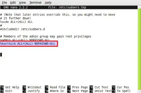

  • If you dont want to enter password everytime,then you should edit sudoers file.
    sudo visudo
  • Then add the following line at the end of the file.
    %username ALL=(ALL) NOPASSWD:ALL
    alt text
  • Now if you enter sudo followed by the command it wont prompt you to enter password.

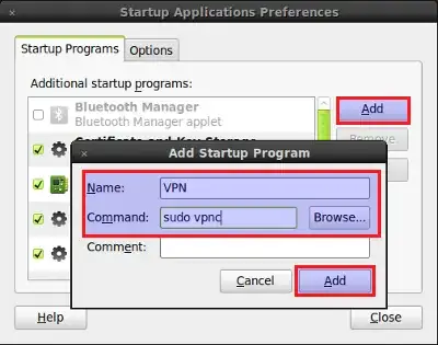

  • For your second question you can add that command sudo vpnc to startup applications.
  • To add that command in startup applications Goto System Preferences Startup Applications.
    alt text
