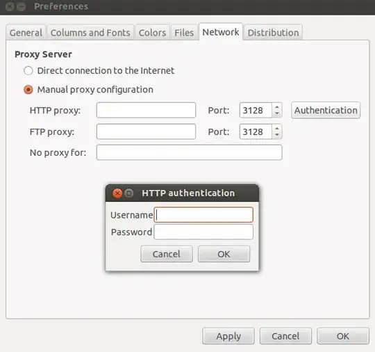

One nice alternative is to use Synaptic Package ManagerInstall Synaptic, where you can specify system independent proxy settings and also store username and password.
Proxy Settings
However, this won't change proxy for Software Center.
