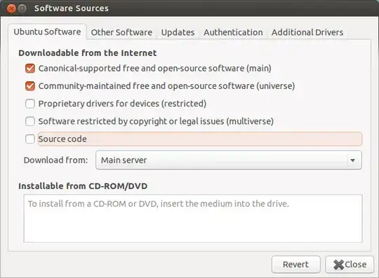

Synaptic is available in the so-called universe repository. If you cannot find that package, it means that you do not have universe enabled. To enable it, follow these steps:
GUI
Open Software Sources and select Community-maintained free and open-source software (universe)
Software Sources
After doing so, you will be asked to reload the software sources and you will be ready to install your package.
