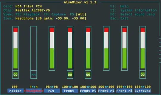

What helped for me was to run alsamixer with headphones in. Then moving right to the column marked "Auto-Mute mode" and pressing down to disable it.
Headphones then worked.
I also ran sudo alsactl store for good luck.
Seems to have worked.

  1. Open your Terminal (ctrl+alt+t)
  2. Enter the command alsamixer -c 1 in terminal
  3. Use right arrow button and go to the headphone view
  4. Press m to unmute it and press up arrow button to increase the sound view

Insert your head phones and in Terminal run the command alsamixer, and then switch the volume bar for headphone by pressing M.
If the sound appears and everything goes smooth then you can save the result of alsamixer by running the command
sudo alsactl store
This should save alsamixer configurations to /etc/asound.state which gets loaded every startup.
