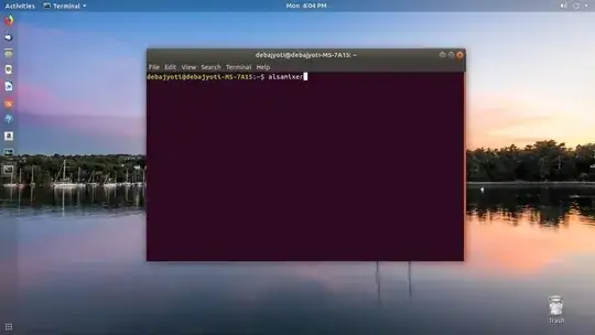

In the ‘Terminal’ write alsamixer

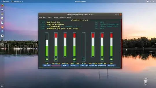

Now press m in Keyboard (mouse dose not work here) to Unmute the Headphone. ( When the Headphone is mute you can see in the column it shows MM, and after you unmute the Headphone, it will show OO) enter image description here
Press up-down arrow keys to control sound in your Headphone.
