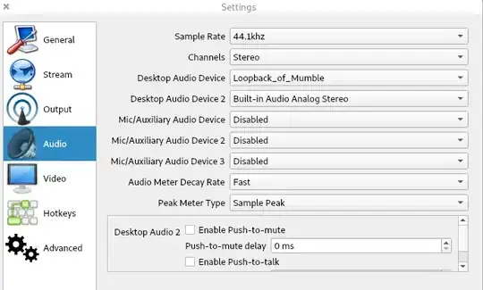

  5. Then, set up your programs to use either "Monitor_of_Mumble" or "VirtualMic" as input device (they are linked). E.g. in OBS:
    Screenshot of OBS configuration
