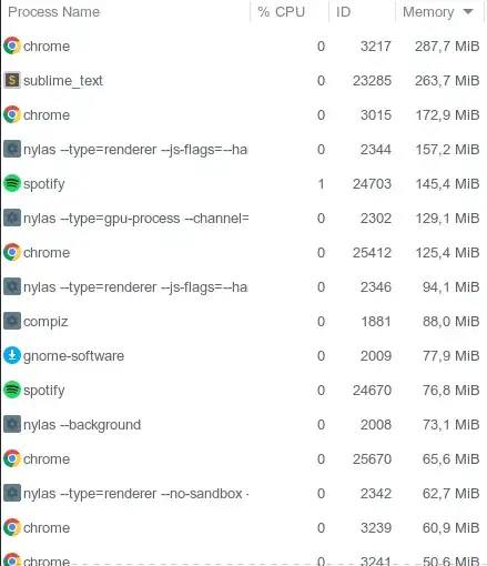

My current process list for reference:
Current process list for reference
