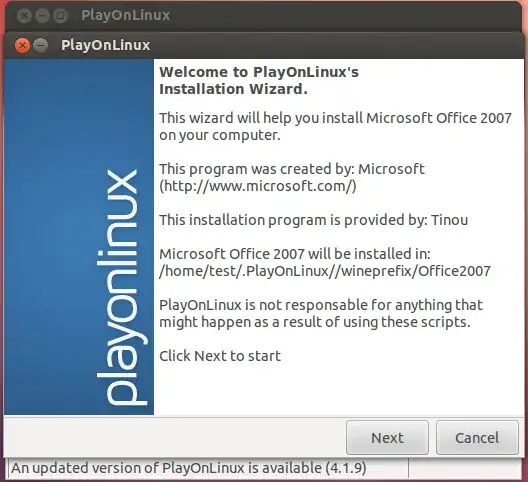

You can install MS Office 2007, with the help of PlayOnLinux. PlayOnLinux is a graphical front-end for the Wine software compatibility layer which aims to simplify the installation of Windows-based applications.
1. Installation of PlayOnLinux
You can install PlayOnLinux from Ubuntu Software Center
Download

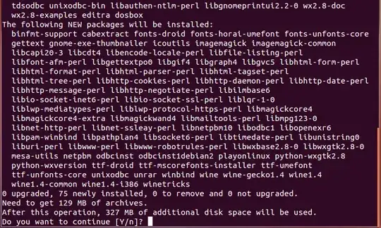

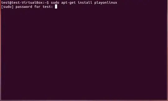

or open a Terminal with Ctrl + Alt + T and type:
sudo apt-get install playonlinux and fill in your password.
Then type Y or yes and hit Enter ↵ to install the package.

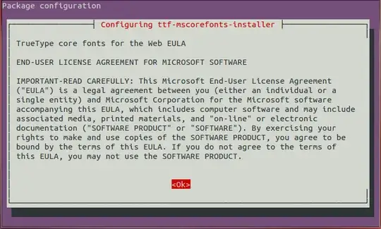

After a while you will need to accept the EULA of mscorefonts. To select the OK option, hit  ⇆ TAB  and then Enter ↵.
When the installation process is finished open PlayOnLinux from dash

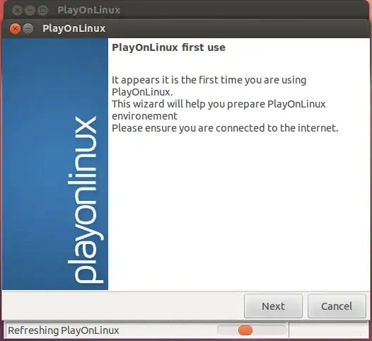

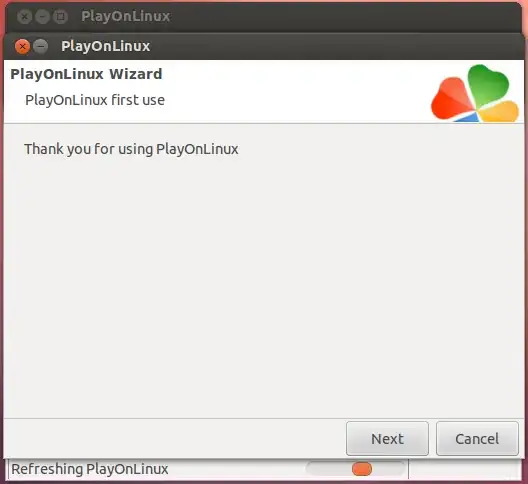

The first time you open it, click Next to set up the PlayOnLinux environment.
After that everything is set up.
2. Mount *.iso or CD-ROM
At this momment, you need to mount the .iso or place in the CD that contains the MS Office 2007.
If you have a .iso file open a Terminal and type
sudo mkdir /media/office07 With this command you'll create a folder with the name office07 in /media.
Next type
sudo mount -o loop ~/filename.iso /media/office07 to mount the image into our new directory.
3. Install MS Office 2007

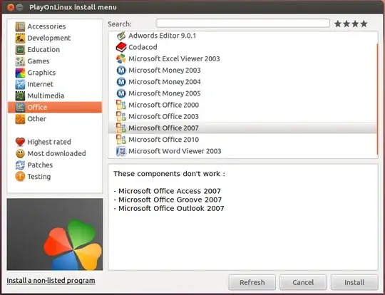

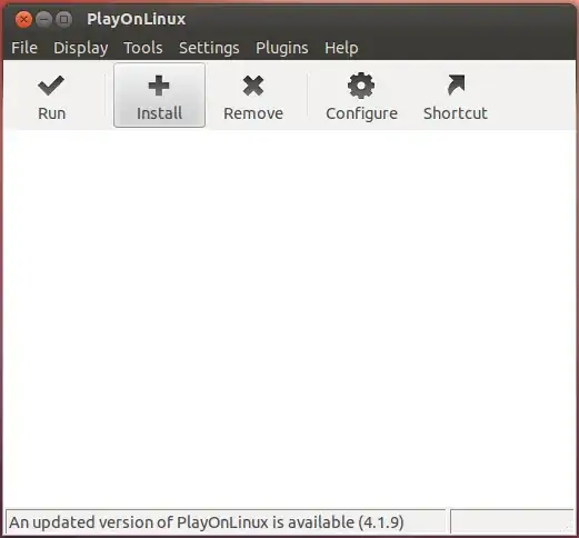

Now switch on PlayonLinux window and click on the button Install to install a new software.
Next, go on the category Office, choose Microsoft Office 2007 and click in the button Install.
Hit Next

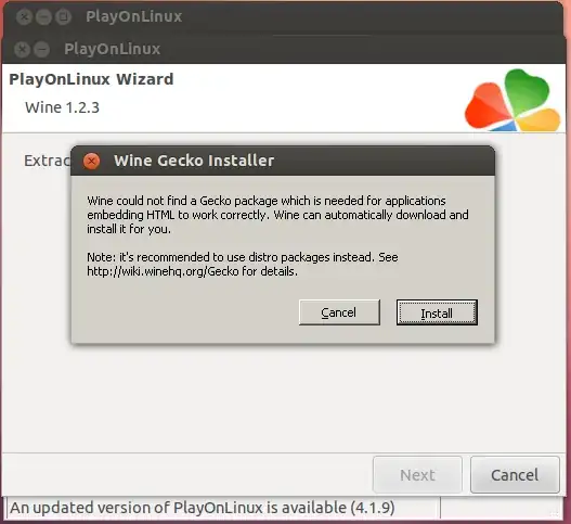

After some time you will be asked to install Gecko Installer. Hit the Install button.

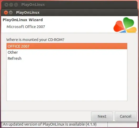

When the installation of Gecko Installer is finished you will have to choose where is your CD/.iso is mounted and click Next.
At last continue as usually

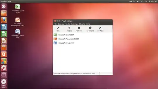

When you finish with installation you will have three new shortcuts in your desktop (Word, Excel, Powerpoint)

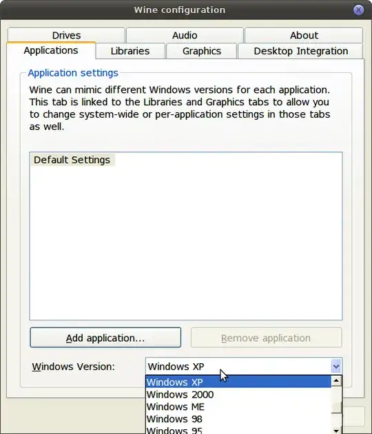

Go to Menu, 'Configure Wine' and make sure your version of wine is set to Windows XP.

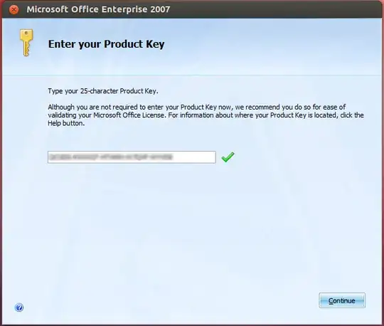

Install Office 2007. (Open the disk and right click on setup.exe and select "Open with wine windows program loader.") The progress bar in the installer window may stop when it reaches about 2/3 of the way. The installation is continuing, even though the progress bar is not moving. Wait for it to finish.

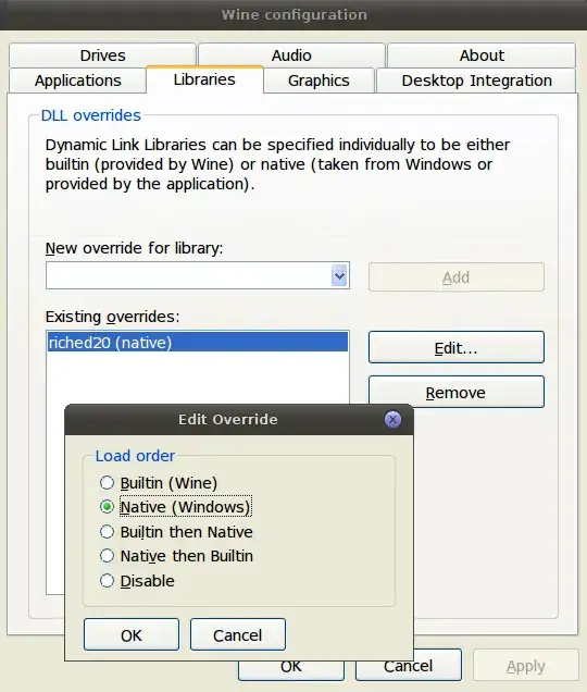

In 'Configure Wine', under the Libraries tab in the area labeled "New override for library" type in riched20.dll and click on Add. You will see it appear in the list below. Now select the riched20 in the list that we just added and click on the Edit button. Set it to Native (Windows) and click OK.
This will allow Powerpoint and the other applications to run correctly.

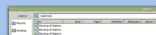

As of Wine 1.6.2 through Wine devel 1.9.16, Excel 2007 runs without any Play on Linux. Macros work, but there are few weird oddities:
  1. The file open/save dialogs lack any attributes - only the filenames are displayed. This is a know issue dating since 2013.
    File attributes are missing
