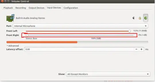

Yup! I had the same problem in Ubuntu 16.10, where it was working perfectly on Skype but didn't work for chrome.
So I solved the problem just by reducing the Front Right slider under Input Devices on PulseAudio Volume Control.
Volume Control settings, Front Right slider all the way down
