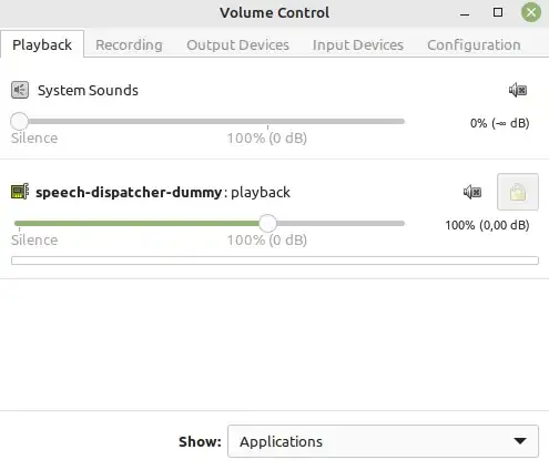

This is what I had to do to get the internal mic to work on my Acer Aspire 5745G:
  • Install pavucontrol:
    sudo apt install -y pavucontrol
  • Run it with:
    pavucontrol
Looks like:

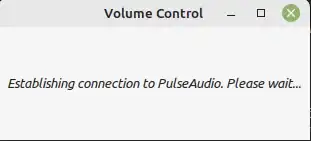

If it hangs and says:
Volume Control. Establishing Connection to PulseAudio. Please wait...
then you have started it with sudo pavucontrol. Do not use sudo.
  • Go to the "Input Devices" tab
  • Click the lock icon to unlock the channels
  • Set the right-front channel to silence
