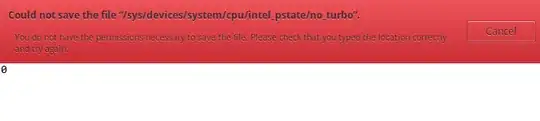

sudo gedit /sys/devices/system/cpu/intel_pstate/no_turbo
It has just one line:
When I try to change it to 0 and save it it says: "Could not save the file “/sys/devices/system/cpu/intel_pstate/no_turbo”." and "You do not have the permissions necessary to save the file. Please check that you typed the location correctly and try again."
