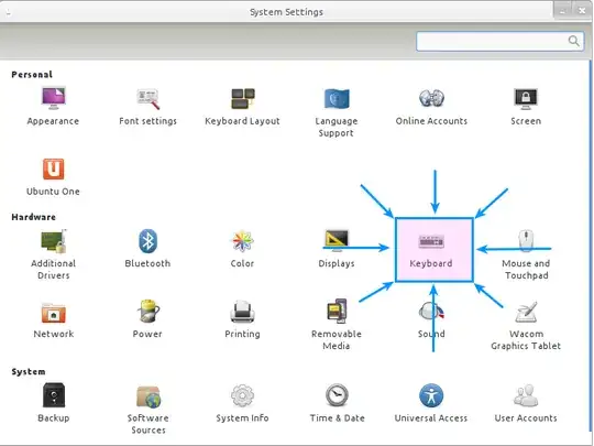

  • Open System Settings.
  • Click on "Keyboard".
  • Go to "Shortcuts".

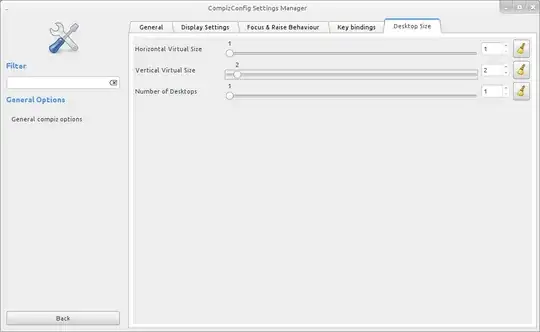

  • Open Compiz Config Settings Manager (install if you don't have it already)
    sudo apt-get install compizconfig-settings-manager
  • Go to General Options and click Desktop Size. enter image description here
  • Set the "Horizontal Size" to 1.
  • Set the "Vertical Size" to 2.
  • When you need more workspaces you can use your Keyboard Shortcut or the Quicklist.

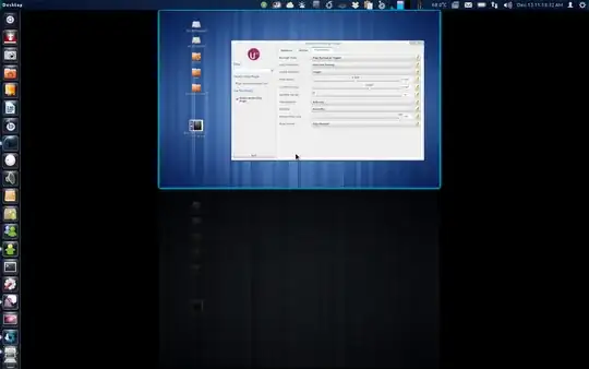

    Workspace demo
