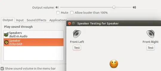

I have an Amazon Echo and a laptop running Ubuntu 16.04.1. I can successfully pair the device via Bluetooth (the Echo says Now connected to <my machine's name>), but when I test the sound, nothing is heard. The volumes are high enough and other devices can connect to the Echo just fine.
No sound through the Echo
Here's the dmesg output:

The solution I found was in sound settings. At first, I could connect, but no sound. In the sound settings, I changed the 'output device' drop-down box to the default, then back to my Echo manually. YouTube video clicked right in.
