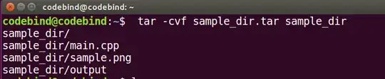

Create tar Archive File by Compressing an Directory or a Single File
The terminal command below will create a .tar file called sample_dir.tar with a directory /home/codebind/sample_dir or sample_dir in present working directory.
ripon@ripon:~$  tar -cvf sample_dir.tar sample_dir
sample_dir/
sample_dir/main.cpp
sample_dir/sample.png
sample_dir/output
ripon@ripon:~$ ls
sample_dir sample_dir.tar
Screenshot of the terminal showing the commands above

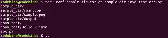

Compressing Multiple Directories or Files at Once
Let’s say, For example we want to compress the sample_dir directory, the java_test directory, and the abc.py file to a tar file called sample_dir.tar.gz.
Run the following command to achieve the goal above.
ripon@ripon:~$ tar -cvzf sample_dir.tar.gz sample_dir java_test abc.py
sample_dir/
sample_dir/main.cpp
sample_dir/output
java_test/
java_test/HelloCV.java
abc.py
ripon@ripon:~$ ls
sample_dir java_test abc.py sample_dir.tar.gz

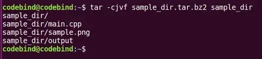

Create .bzip2 Archive File by Compressing an Directory or a Single File
ripon@ripon:~$ tar -cjvf sample_dir.tar.bz2 sample_dir
sample_dir/
sample_dir/main.cpp
sample_dir/output
ripon@ripon:~$
Notice that we have added extra flag -f to the command.Here’s what the flag -f actually mean
-f, --file ARCHIVE– use archive file or device ARCHIVE
