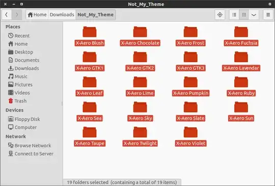

  1. Create a new folder and fill it with anything you want, for example many of file (In my case, I'll fill it with theme folder) : enter image description here

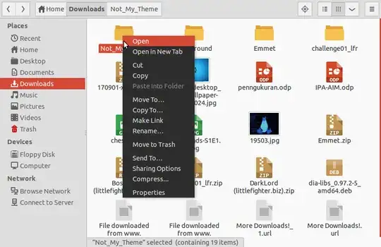

  1. Right click the folder you want to zip and select "Compress..." option : enter image description here

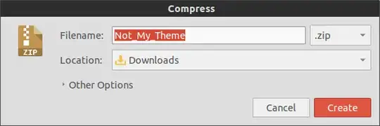

  2. You can choose which file format you want by clicking combobox next to "Filename" textbox. Also you can set the folder you want to zip location. enter image description here

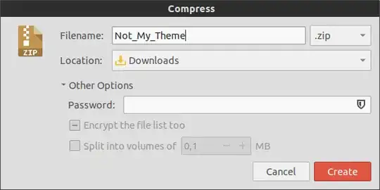

Clicking "Other options" will lead you to password section, in other word you can set password for your preferred file so someone (include you) have to enter password before unzip the file. enter image description here
