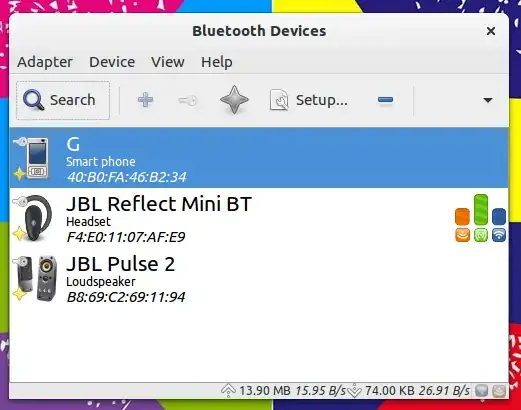

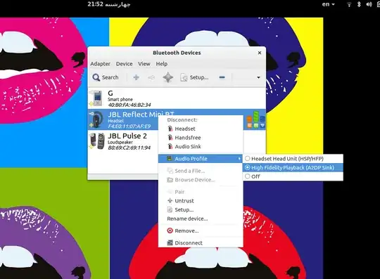

I know it's a late answer, and the answers are great, but just to clarify for people who are a little confused about the answers like I was, here's a step by step guide:
  1. install blueman from official repositories:
    sudo apt-get install blueman
  2. open the bluetooth manager, from applications menu or the tray icon.enter image description here
  3. Select your device, and follow the wizard to connect it (It's really easy, and you can alternatively do this step using your desktop manager's built-in bluetooth settings) blueman after connecting the device
  4. After you connected your bluetooth device, right click on its name in the blueman and select Audio Profiles > High Fidelity Playback (A2DP Sink) like this : selecting audio profile
hope this helps.

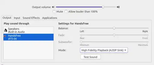

Go to ***Sound Settings*** and set Mode: to "High Fidelity Playback (A2DP Sink)" from "Headset Head Unit (HSP/HFP)"
Go to Sound Settings and set Mode: to "High Fidelity Playback (A2DP Sink)" from "Headset Head Unit (HSP/HFP)"

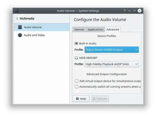

Also have Sony MDR-XB950BT. Kubuntu 18.04 LTS. Open System settings > find "Configure the Audio Volume" > select "Advanced" tab. Find "Built-in Audio" > press "Profile:" combobox and select Digital Stereo (HDMI) Output. Worked for me.
