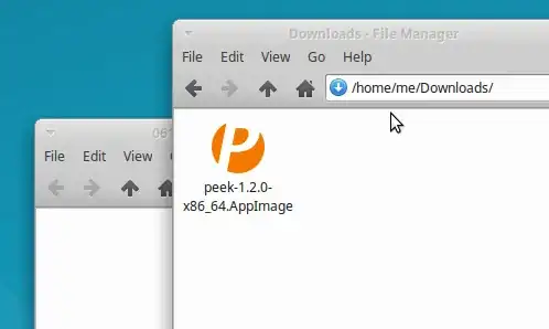

Download from site, then drag-and-drop a single file in the file manager to desired installation location.
drag-and-drop

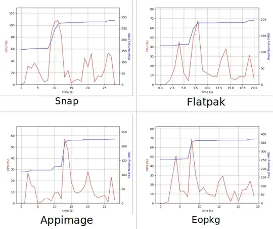

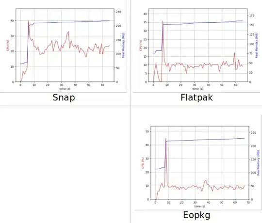

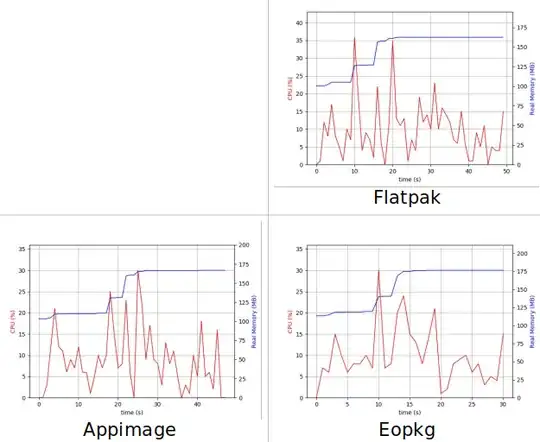

I have found an interesting performance (CPU+Memory) comparison for these packaging systems.
VLC
VLC
LibreOffice enter image description here
Gimp
Source: https://verummeum.com/portable-package-formats/
