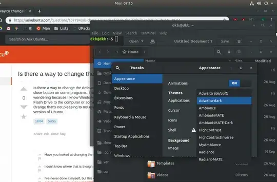

  • Open Tweaks, which is what the gnome-tweak-tool appears as in the Dash, and choose from what you've installed. Changes are immediate.
  • In the attached image, I've used Adwaita Dark.
Change themes

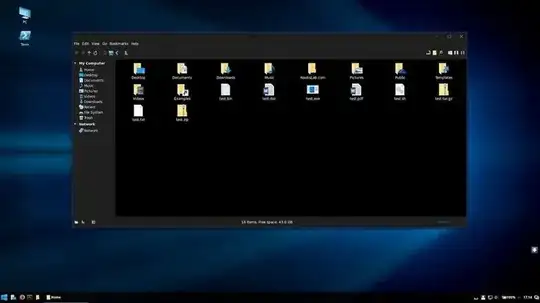

1. Windows 10 Theme
If you admire the appearance of Redmond’s latest operating system, you can mimic the theme on your Ubuntu desktop. If you are looking for something really transforming and prevent unwanted attention, the Windows 10 unity themes might just be the one.

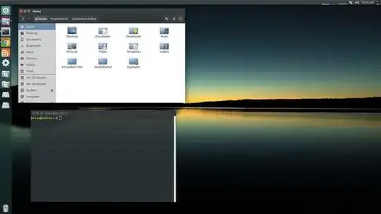

10. Yosembiance
Yosembiance adds a gentle touch of smoothness and flatness to the typical Ambiance theme that ships with Ubuntu. So if you want a theme very much Ubuntu with just a touch of MacOS, Yosembiance is just the one. Yosembiance comes in Atomic, Kraken and Ubuntu all with options in Blue and Orange.
