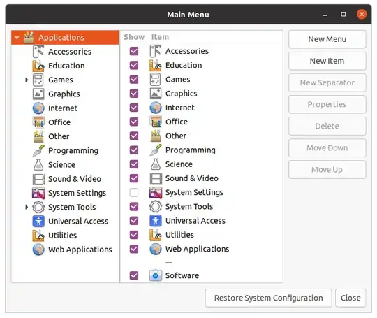

One way would be to install Alacarte.
In terminal enter sudo apt install alacarte
When the app is installed, launch it then follow these step-by-step instructions to edit app names with the tool.
Step 1: Once Alacarte is open, you will see a tree on the left-hand side of the app listing different categories. All of the apps on your system are sorted into these categories.
Click on a category with the mouse to view the various app shortcuts within.
Step 2: Click on the app shortcut in Alacarte that you’d like to edit using the mouse. By clicking on the app shortcut, Alacarte will highlight it.
Step 3: With the app shortcut highlighted, find the “Properties” button on the right-hand side of the app window, and click on it with the mouse.
Step 4: Upon clicking on the “Properties” button, a window will appear. In this window, look for the “Name” section. Then, erase the existing name and set it to whatever you’d like to change it to.
