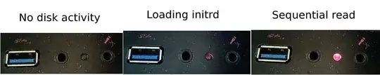

So I noticed something interesting about the HDD activity light. When loading the initrd, it's almost as if the light is being PWMed at a 10% duty cycle or something. This makes me wonder if GRUB's read is not optimized, maybe something like it's doing an OS call to read each byte rather than reading the image as a byte stream?

The disk activity light on my tower stays on for the entire 7 seconds...

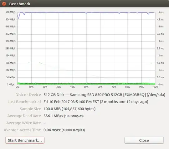

Ubuntu can read my SSD at its maximum speed of 550MB/sec...

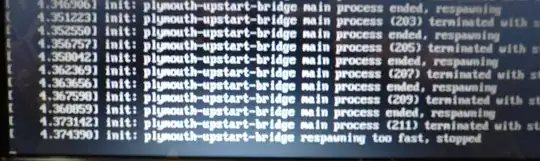

So I removed the quiet splash $vt_handoff parameters from the boot command in GRUB on my laptop (keep in mind this laptop does not have an SSD), and noticed a very interesting thing during the boot sequence:
It hangs on this line for 15 seconds:
[    4.374390] init: plymouth-upstart-bridge respawnng too fast, stopped
Here's a (low quality) picture:
Not sure what the significance of that is...
