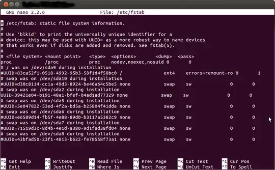

edit fstab to deprecate unneeded swap partitions
Open a terminal in the usual manner
Type in sudo nano -B /etc/fstab, as an example from mine⋯
# /etc/fstab: static file system information.
# Use 'blkid' to print the universally unique identifier for a
# device; this may be used with UUID= as a more robust way to name devices
# that works even if disks are added and removed. See fstab(5).
# <file system> <mount point>   <type>  <options>       <dump>  <pass>
proc            /proc           proc    nodev,noexec,nosuid 0       0
# / was on /dev/sda9 during installation
UUID=83ca52f1-0518-4992-95b3-58f1d4f58bc0 /               ext4    errors=remount-ro 0       1
# swap was on /dev/sda10 during installation
UUID=d30c8114-cc1a-49d3-8924-be46a64c5be5 none            swap    sw              0       0
# swap was on /dev/sda2 during installation
UUID=39421e04-b191-48a1-bfef-04ad1ad77329 none            swap    sw              0       0
# swap was on /dev/sda5 during installation
UUID=5e047822-53ed-4f2a-bd5a-b25804f41dda none            swap    sw              0       0
# swap was on /dev/sda6 during installation
UUID=e6589d14-fb5f-4e88-89d0-b3117a5382c9 none            swap    sw              0       0
# swap was on /dev/sda7 during installation
#UUID=71519d3c-8d4b-4e1d-a380-9d1f8d38fd04 none            swap    sw              0       0
# swap was on /dev/sda8 during installation
UUID=43bfad50-23f1-4813-b622-fe78558f73a1 none            swap    sw              0
To stop the unwanted swap partitions from being used on your computer, just add a "#" to the front of the line. Use the notes from "gparted"
So now it should look like this⋯
Save the changes with Ctrl-O and Enter, then close with Ctrl-X
And reboot.
Now the system should be faster to complete booting.
