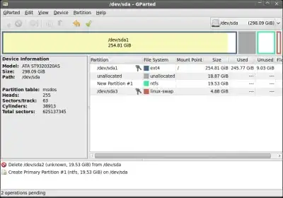

You can use gparted to resize your root partition and take back the space that your swap partitions were taking.
It has a nice graphical interface and its as simple as dragging size arrows to move and resize partitions, no need to reformat and gparted will take care of all the small details involving the partitions resizing.
Boot from the Ubuntu 11.10 LiveCD, install gparted with by looking for it in the Ubuntu Software Center, run it and take your space back using the nice interface
and the easy to use resize partitions screen
Note that you need to do it from the LiveCD since you cannot resize a currently mounted partition. And of course has with all partition resizing operations you should back up at least your most important data, that goes almost without saying.
