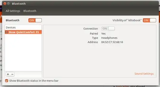

However, in the bluetooth GUI menu, it seems to think I'm paired with the device:

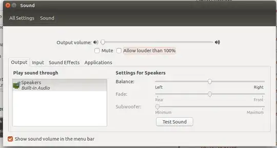

The headphones themselves never seem to recognise that the laptop is connected, and in my sound settings I don't see anything that I can output to, so the "pairing" is bogus I think.

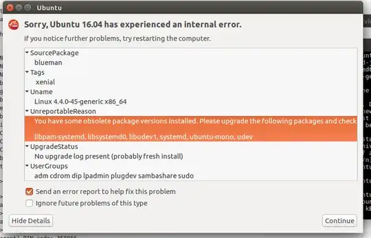

I tried using blueman as suggested, which crashes whenever I try to pair my device.
I tried upgrading the suggested packages by running
sudo apt-get install libpam-systemd libsystemd0 libudev1 systemd ubuntu-mono udev
This stopped the error from appearing but I was still not able to pair with blueman (no error, it just doesn't do anything when I try to pair).
