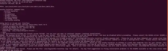

When installing CUDA in Ubuntu 16.04 by executing cuda_8.0.44_linux.run,
I got the following error message in /var/log/nvidia-installer.log
Then I checked /etc/modprobe.d/nvidia-installer-disable-nouveau.conf and got
Any suggestion to disable Nouveau Kernel Driver?
