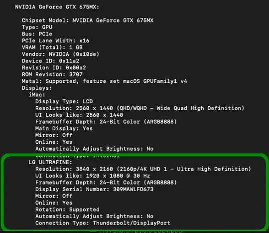

The only problem I have is that I can not get an external 27" monitor to be detected. The external monitor does work OK on MacOs Catalina.
(For readability I have cleaned up this post drastically.)
System Profiler command on MacOs (same machine) : with a new cable, a good one. On MacOs, I have a perfect view.
External MacOs - good cable

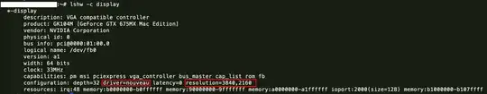

But.... when I update the driver to the nouveau driver via the Ubuntu settings screen, (see below), then Ubuntu graphical env. does not start up. And then I also see something strange, I think it is related to the external monitor :
lshw -c display
nouveau driver via ubuntu

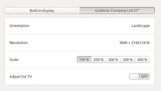

NVIDIA before reboot Display settings before reboot 2 displays working

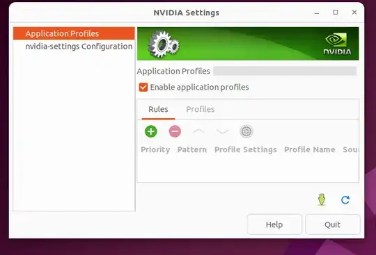

Check the different outcome from the nvidia tool AFTER THE REBOOT:
NVIDIA 1 after reboot
NVIDIA 2 after reboot

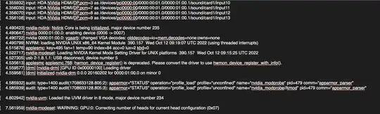

Check the DMESG entries related to NVIDIA and external monitor working OK:
dmesg OK

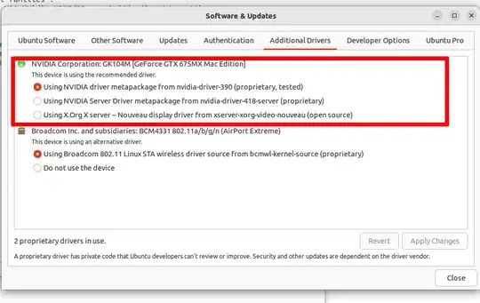

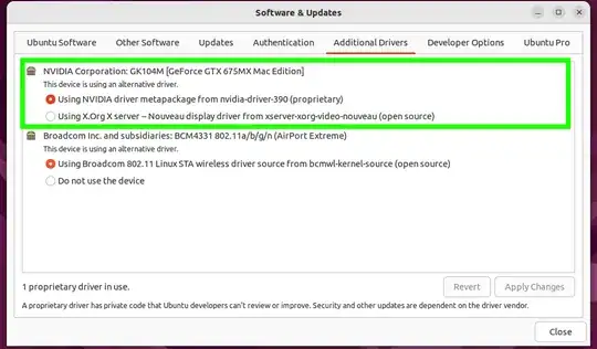

I found the solution.... very simple :
I think the nvidia-driver-390 package is broken in kernel 6.5.0-21 (and not in 6.2.0-26, the one on my live USB). This is my solution:
See what drivers are available
ubuntu-drivers devices
Then remove the bogus 390 and install 418
apt remove nvidia-driver-390
apt-get clean && apt-get autoremove
apt install nvidia-driver-418
Now, also the dkms-390 errors are gone.
reboot
Et voilà.

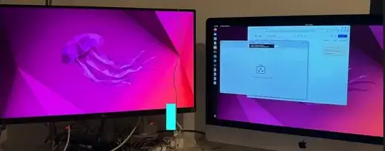

The only issues to solve are
  1. I have to leave the external monitor powered-off or disconnect the cable at boot, and turn it on / plug it in later. Really power-off/unplug, not just 'standby'. If I don't that, the login-screen shows up on external monitor, but after logging in, the screen remains on but grey.
  2. Sometimes, max resolution is 4K, other times just 2K (I do not care). I was surprised it supports 4 k at all!

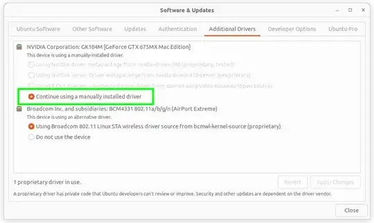

DO NOT USE THE UBUNTU SOFTWARE APP TO INSTALL nvidia-driver-418 ! I really had to use the command line.
Don't ask all the steps I took, I don't know anymore. The true hint was that I did not saw any nvidia modules in the latest kernel, and started looking for that, and then I also noted that lsmod | grep nvidia did not return any values, even though nvidia 390 seemed to be installed. I am not an expert but seems a bug in Ubuntu or Linux.

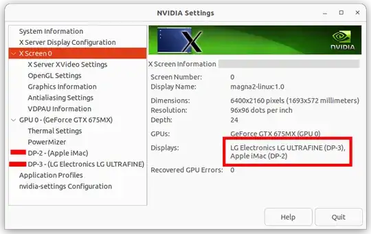

As I expected, at certain moment I would update my Ubuntu and kill my '2 screens setup'.
I ran
nvidia-xconfig
And now it works again.
Blacklisting nouveau did NOT work

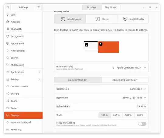

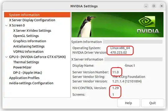

Here some pics:
NVIDIA OK
additional drivers
