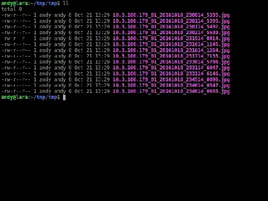

I have a number of files:
I want to rename with this format:
It needs to remove the _ in timestamp and add the _TIMING.
