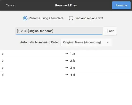

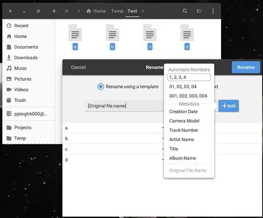

12
  1. Open your directory in Nautilus.
  2. Highlight all of the files.
  3. Right-click, and select "Rename..." from the context menu.
  4. On the Rename dialog, click the +Add button.
  5. Select "1,2,3,4" under "Automatic Numbers"
  6. Then, in the Rename dialog, in the text entry field, insert an underscore "_" character between "[1, 2, 3]" and "[Original file name]".
    It should look like "[1, 2, 3]_[Original file name]"
  7. Click the Rename button.
Select "1,2,3,4" in the Rename dialog
The renamed files
