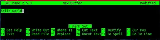

  1. Position the cursor at the beginning of the character from which you want to copy. Press Alt+Shift+A to set mark. ( Alternatively, set mark with Ctrl+6 )
  2. Use arrow keys to highlight the text to copy. highlight with nano image
  3. Use Alt+Shift+6 to copy (Alternatively, Alt + 6 )

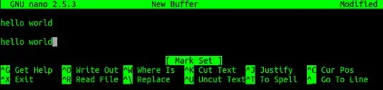

  4. Navigate to the place you want to paste. Release paste with Ctrl+U
    paste image
