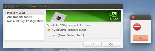

After switching between Intel / NVIDIA graphics and the different NVIDIA drivers I am now suddenly stuck with the Intel GPU. It used to be no problem at all switching between the two - I cannot say for sure what is suddenly causing the issue. I think the last thing I did was switching to the "X.Org X server" driver - then something broke. The switching was part of me trying to troubleshoot issues with setting up a secondary screen.
Every time I try to switch to NVIDIA I get this very expressive error message and then it switches back to Intel :/
I could use some assistance with troubleshooting or suggestions on what to try.
