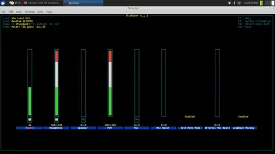

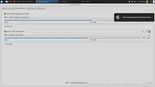

I have an ASUS laptop dual booted with Windows 8.1, I upgraded from 15.10 to 16.04 and lost use of the speakers; the soundcard perpetually thinks the headphones are plugged in, as evidenced by these screenshots.
alsamixer
pavucontrol

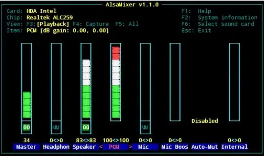

    alsamixer
You should see the following:
alsamixer Due to differences between sound cards, your devices my be a little different from those in the image. In my case, and before fixing the problem, my alsamixer looked just like the image above.
  1. Unmute any devices that are currently muted (use 'm' key to toggle mute). Then raise the volume sliders up on any devices that are not at 100%.
If you can hear sound from your speakers, this fix is for you!
If you do not hear any sound, go back to "The Google" and keep searching. This will method will NOT help you.
If you successfully got sound from the above the test, what we need to do now is play with the alsamixer settings in order to determine:
  1. Which device's volume control actually controls the volume of your speakers, and
  2. Which of the devices need to be unmuted for the speakers to work. Multiple devices may need to be unmuted.
Once we know the ALSA settings by which the speakers will work, we can use this information to make the necessary changes to our PA mixer paths.
In my case, I discovered that my headphones and speakers are linked within ALSA in the following ways:
  1. My Headphone Volume is controled by the "Headphone" device.
  2. Getting sound from my headphones requires that the "Master" and "Headphone" devices be unmuted.
  3. My Speaker Volume is ALSO controlled by the "Headphone" device. (The ALSA speaker volume setting suprisingly has no effect on my speaker's volume.)
  4. Getting sound from my speakers requires that the "Master" and "Speaker" devices be unmuted.
The speaker's default mixer path within PulseAudio(PA) assumed that my speakers were independant of my headphones. Which, as demonstrated above by observation 3, was not the case. Subsequently, the default mixer path within PA for my speakers made the following problematic changes within ALSA whenever the speaker output was selected within PA:
  1. Dropped the headphone volume to 0.
  2. Set the speaker device as the volume control.
Given how I had observed ALSA's linkage of my speakers and headphones as described earlier, these changes to ALSA would prevent sound from coming out of my speakers.

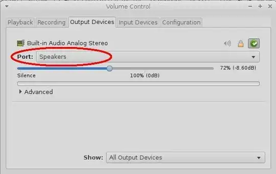

  1. Make sure that your speaker output is selected within PA (i.e. not your headphones). enter image description here

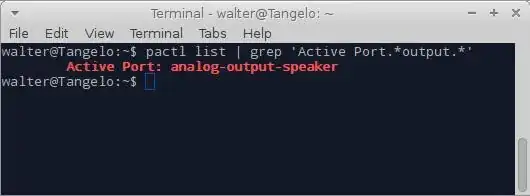

  2. Open a terminal and run the following command:
    pactl list | grep 'Active Port.*output.*'
  3. It should output something that looks like this:
    Active Port: audiotype-output-device
i.e.
The "active port" is the PA port currently controlling the ALSA settings. Since you already selected your speaker as the PA output, this output from the terminal command tells you that you need to edit the mixer path file audiotype-output-device.conf. In my case, the mixer path file was analog-output-speaker.conf.
