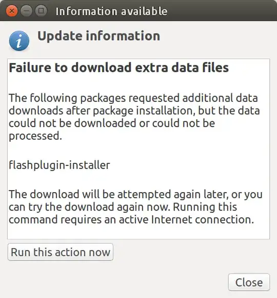

The Error Screen
Flashplayer Error Screen

This problem seems to have ocurred after I removed google-chrome-beta but kept the regular google-chrome. Google chrome works fine for watching TV shows with pepper flash plug-in but it would be nice to keep firefox as a backup browser if chrome goes down. I believe firefox needs the separate flashplugin.
Is there a glitch in canonical somewhere?

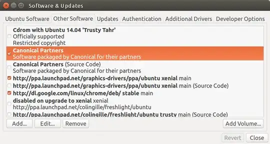

showed up because Canonical partners was not enabled. I don't remember turning it off but the solution is to turn it on.
Enable Canonical Partners
To enable partners in Canonical select System Settings then Software & Updates and then Other Partners. This screen appears:
Canonical Partners
Check the box to allow partners.
