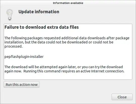

Am running Chromium on 13.04. For the last few days every morning I get a notification that says "Failure to download extra data files." The dialog box specifically indicates pepflashplugin-installer and has a prompt "run this action now."
If I run the action, no complaints. At some point, the dialog will return. If I run the the installer from the CLI, my system tells me that I already have the latest version.

I removed the flashplugin-installer and reinstalled it using these steps: http://www.webupd8.org/2013/04/install-pepper-flash-player-for.html
This is what I did:
sudo apt-get remove  flashplugin-installer
sudo add-apt-repository ppa:skunk/pepper-flash
sudo apt-get update
sudo apt-get install pepflashplugin-installer
Then check that chromium uses Pepper Flash Player.
sudo vim /etc/chromium-browser/default
The last line in default needs to read
. /usr/lib/pepflashplugin-installer/pepflashplayer.sh
If not, add it to the file.
Here's what my default file reads:
# Default settings for chromium-browser. This file is sourced by /bin/sh from
# /usr/bin/chromium-browser
# Options to pass to chromium-browser
CHROMIUM_FLAGS=""
That's it. I didn't get bothered by that error anymore.

This helped me:
sudo rm /var/lib/update-notifier/package-data-downloads/*
sudo rm /var/lib/update-notifier/user.d/data-downloads-failed*
At times its because of your proxy.
When you have set the environment proxy as :
http_proxy=proxy.bla.bla.bla:933
https_proxy=proxy.bla.bla.bla:933
ftp_proxy=proxy.bla.bla.bla:933
this is not accepted and the download fails. (Am not sure why, probably code standard difference)
hence your proxy has to be in full form :
http_proxy=http://proxy.bla.bla.bla:933
https_proxy=http://proxy.bla.bla.bla:933
ftp_proxy=http://proxy.bla.bla.bla:933
It solve my problem with this simple tweak at least.

Just ran across this problem, with the same dialog box popping up every day or so. A variant on what the OP tried worked for me:
sudo apt-get --reinstall install pepflashplugin-installer

I have the same problem and it boils down to my proxy settings not being used. The easiest solution I've found is to run (note the -E)
sudo -E apt-get --reinstall install flashplugin-installer
when the pop-up horror starts again. Not very elegant but it works for me.
